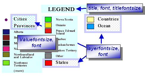

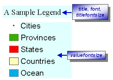

When parent element is PROPERTIES when using ArcMap Server:
Attribute Usage Back to Top
autoextend Extends the legend to accommodate information for all layers. Should always be set to "true" with ArcMap Server.
backgroundcolor Legend’s background color using RGB values.
display Turns legend on or off.
font Font for title. The name is case sensitive. If font name uses "&", use "&amp;" instead. For example, ESRI Transportation & Civic should be written as ESRI Transportation &amp; Civic.
layerfontsize Sets the font size of the childheading for layers that include a value map.
swatchheight Height of the symbol swatch in pixels.
swatchwidth Width of the symbol swatch in pixels.
title Title of legend.
titlefontsize Font size for title.
valuefontsize For layers that include a value map, it sets the font size for value map labels. For layers with no value map, it sets the font size for the layer name.

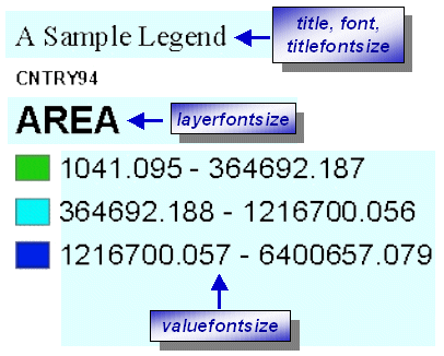

When parent element is PROPERTIES when using Image Server:
anitaliasing Used to make edges of labels and symbols smoother. When set to "true", antialiasing is active. Note that the time to generate a map may significantly increase when antialiasing is turned on.
autoextend If "true", automatically extends legend vertically past size specified in height, if needed.
cansplit Allows splitting of valuemap layers between columns.
cellspacing Defines number of pixels to pad between entries.
columns Defines number of columns in legend.
font Font for title. The name is case sensitive. If font name uses "&", use "&amp;" instead. For example, ESRI Transportation & Civic should be written as ESRI Transportation &amp; Civic. For Feature Services, the font must reside on the client machine or else the system default font is used.
height Legend height in pixels.
layerfontsize Font size for layer labels.
reverseorder Reverse order of layers.
splittext Text that displays in bottom of a column if a valuemap is carried over into the next column.
transcolor Transparency color using RGB values. White is 255,255,255.
valuefontsize Font size for value map labels.
width Legend width in pixels.
