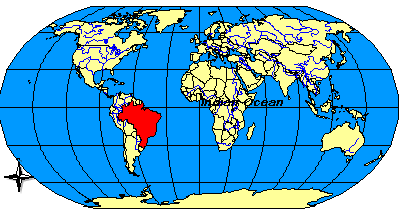

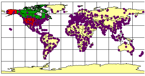

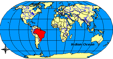

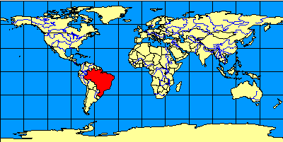

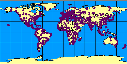

The returned map image is generated using defaults from the Image Service. The visible layers shown are Ocean, Countries, States, Provinces, and Cities. Also, the map is in geographic coordinates, and the default envelope includes the entire world.
Default Image

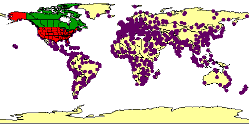

Using autoresize
During a GET_IMAGE request, the maximum size of an image can be no greater than the image memory limit set when an Image Service is started. For example, an image memory limit of 1 MB allows a map no larger than 262,144 pixels (512 x 512) to be generated. By default, an image is limited in size to 4 MB, which corresponds to 1,048,576 pixels. Changes can be made to the image size and pixel count using the ArcIMS Administrator. For more information, see Using ArcIMS.
If autoresize is set to "true" in GET_IMAGE, a requested map greater than the maximum pixel count is reduced in size to within the maximum pixel count. In the next example, the Image Service image limit is 4 MB. IMAGESIZE requests an image greater than 4 MB. (IMAGESIZE is discussed in greater detail in the Changing the Output IMAGESIZE Section.)
GET_IMAGE request with autoresize="true":
<?xml version="1.0" encoding="UTF-8" ?>
<ARCXML version="1.1">
  <REQUEST>
    <GET_IMAGE autoresize="true">
      <PROPERTIES>
        <IMAGESIZE width="2000" height="1600" >
      </PROPERTIES>
    </GET_IMAGE>
  </REQUEST>
</ARCXML>

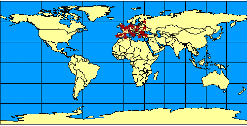

Zoom and Pan with ENVELOPE
When a user pans or zooms on a map, what really happens is that the map extent changes. In a GET_IMAGE request, the extent is changed by sending new x,y minimum and maximum coordinates in an ENVELOPE. This new envelope overrides the envelope set in the Image Service. In the following example, the envelope zooms into the region around Europe.
GET_IMAGE request with a change in ENVELOPE:
  <REQUEST>
    <GET_IMAGE>
      <PROPERTIES>
        <ENVELOPE minx="-13" miny="37" maxx="40" maxy="65" />
      </PROPERTIES>
    </GET_IMAGE>
  </REQUEST>
</ARCXML>
The returned map image includes only Europe. All other information on the layers continues to use defaults from the Image Service.

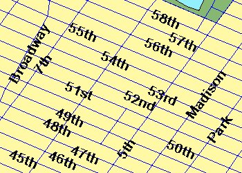

IMAGESIZE sets the size of the output map image in pixels. If IMAGESIZE is not used in a request, the default image size is 400 x 300 pixels. As noted in the using autoresize section, the maximum size of an image can be no greater than the image memory limit set when an Image Service is started.
The output image sizes can be controlled three ways using the following attribute groups: The following example, using a New York City street Image Service, shows a GET_IMAGE request with IMAGESIZE. The width and height are set to 250 and 175 pixels, respectively.
GET_IMAGE request using IMAGESIZE:
  <REQUEST>
    <GET_IMAGE>
      <PROPERTIES>
        <ENVELOPE minx="-73.985" miny="40.756" maxx="-73.972" maxy="40.765" />
        <IMAGESIZE width="250" height="175"/>
      </PROPERTIES>
    </GET_IMAGE>
  </REQUEST>
</ARCXML>

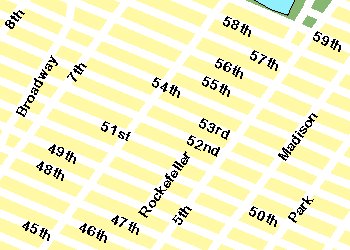

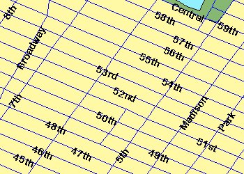

Depending on the combination of IMAGESIZE attributes and ENVELOPE size used in the request, the results of the returned map image may differ.
Width and height
Width and height are required attributes. They are used to draw a map at the specified width and height based on the envelope. If width and height are changed but the envelope remains the same, the scale of the map changes. In other words, if width and height are increased, the map is larger and, in effect, "zoomed in". If a scale threshold is met, the symbology of a layer may change or a layer might be added or removed.
In the two images below, a set of streets in New York City is shown. The first map is 250 x 175 pixels in size. The second map has the same extent but is 350 x 250 pixels. Note that symbology has changed for the streets. By making the map larger and zooming in, a scale threshold was met instructing the ArcIMS Spatial Server to change the street symbols.
250x175 pixels:
Width and length are 250 x 175
<PROPERTIES>
  <IMAGESIZE width="250" height="175" />
</PROPERTIES>
350x250 pixels:
Width and length are 350 x 250
<PROPERTIES>
  <IMAGESIZE width="350" height="250" />
</PROPERTIES>
Printwidth and printheight
To avoid having the symbology change or having layers added or removed when the map size is increased or decreased, two sets of attributes are available: printwidth and printheight or width, height, and dpi. By using one of these attribute sets, the output image contains the same information regardless of the size.
In the examples below, printwidth and printheight are used. The scale factors and dependencies are calculated based on the height and width attributes, and the print attributes instruct the spatial server what size to draw the image. In the examples below, the first image has the printwidth and printheight set the same as the width and height. In the second image, the width and height remain the same, but the printwidth and printheight are increased. The two images contain the same content even though they are different sizes. The ratio for calculating the print map is printwidth / width. In this example the ratio is 350 / 250 or 1.4. The output map is 1.4 times the size of the original map.
The height and width of the second and third images is the same but the size of the symbology is different. In order for symbols to scale, the attribute scalesymbols must be used. By default, the symbols do not scale in size when the map size is increased or decreased. The second image below shows the map with scalesymbols set to "false", and the labels are the same size as in the first image. The third image, on the other hand, has scalesymbols set to "true". When this attribute is used, the symbols increase and decrease in size proportionally as the image size increases or decreases. In the third example below, the symbology has increased proportionally in size so that it is also 1.4 times the size of the symbology in the original map.

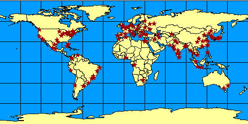

Using BACKGROUND
BACKGROUND is used to define a color for the image background. It can also be used to make one color in the image transparent. Depending on the browser, the image formats that support transparent colors vary. JPG images do not support transparent colors. The table below lists which image formats support transparent colors for different browsers.
Browser Supported Transparent Image Formats
ArcIMS HTML Viewer in Internet Explorer PNG8, GIF
ArcIMS HTML Viewer in Netscape 4.x GIF
ArcIMS HTML Viewer in Netscape 6.x PNG8, GIF
ArcExplorer 4 PNG24, PNG8, GIF
ArcIMS Java Viewers in Internet Explorer and Netscape PNG24, PNG8, GIF
To make a color transparent, both the color and transcolor attributes of BACKGROUND must be set to the same color. In the following request, the transparent color is the blue color in the Ocean layer.
GET_IMAGE request using BACKGROUND:
  <REQUEST>
    <GET_IMAGE>
      <PROPERTIES>
        <ENVELOPE minx="-180" miny="-90" maxx="180" maxy="90" />
        <IMAGESIZE width="500" height="400" />
        <BACKGROUND color="0,153,255" transcolor="0,153,255" />
      </PROPERTIES>
    </GET_IMAGE>
  </REQUEST>
</ARCXML>
In the returned image, the ocean is now transparent.
Transparent Background
        <LAYERLIST>
          <LAYERDEF id="0" visible="true" /> <!--Ocean-->
          <LAYERDEF id="1" visible="true" /> <!--Countries-->
          <LAYERDEF id="2" visible="false" /> <!--States-->
          <LAYERDEF id="3" visible="false" /> <!--Provinces-->
          <LAYERDEF id="4" visible="true" /> <!--Cities-->
        </LAYERLIST>
      </PROPERTIES>
    </GET_IMAGE>
  </REQUEST>
</ARCXML>
In the returned image, the States and Provinces layers are not included. Ocean, Countries, and Cities remain visible.

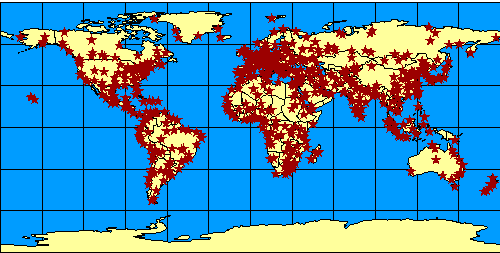

The symbology of a layer can be changed using LAYERDEF. If no symbology information is included, then the default symbology in the Image Service is used. By adding symbology to LAYERDEF, the service information is overridden. In the next example, SIMPLERENDERER is used to change the color and symbol type for the Cities layer. The syntax for adding or modifying renderers is the same as for a map configuration file. For more information, see Using Renderers.
GET_IMAGE using LAYERDEF to change layer symbology:
<?xml version="1.0" encoding="UTF-8"?>
  <REQUEST>
    <GET_IMAGE>
      <PROPERTIES>
        <LAYERLIST>
          <LAYERDEF id="4" visible="true" >
            <SIMPLERENDERER>
              <SIMPLEMARKERSYMBOL type="star" color="155,0,0" width="12" />
            </SIMPLERENDERER>
          </LAYERDEF>
        </LAYERLIST>
      </PROPERTIES>
    </GET_IMAGE>
  </REQUEST>
</ARCXML>
In the returned image, the Cities layer (id="4") is rendered with red stars rather than purple circles.
  <REQUEST>
    <GET_IMAGE>
      <PROPERTIES>
        <LAYERLIST>
            <SPATIALQUERY where="POPULATION &gt; 2000000" >
              <SPATIALFILTER relation="area_intersection">
                <ENVELOPE minx="-14" miny="35" maxx="33" maxy="64" />
              </SPATIALFILTER>
            </SPATIALQUERY>
            <SIMPLERENDERER>
            </SIMPLERENDERER>
          </LAYERDEF>
        </LAYERLIST>
      </PROPERTIES>
    </GET_IMAGE>
  </REQUEST>
</ARCXML>
In the returned image, only cities with a population greater than two million within Europe are rendered with red stars.
Attribute and Spatial Query

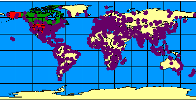

The layer drawing order can be changed by using the order attribute in LAYERLIST. When order is set to "true", layers are drawn in the order listed in the LAYERDEF elements. Only layers in the LAYERLIST are drawn whether or not the attribute nodefault is used. Changing the order of the layers does not affect the order in which layers are shown in a legend.
In the next example, the Cities layer (id="4") is drawn before the States (id="2") and Provinces (id="3") layers. Also, the Ocean layer (id="0") is not included in the list.
GET_IMAGE using order in LAYERLIST:
  <REQUEST>
    <GET_IMAGE>
      <PROPERTIES>
        <LAYERLIST order="true">
          <LAYERDEF id="2" visible="true" /> <!--States-->
          <LAYERDEF id="3" visible="true" /> <!--Provinces-->
        </LAYERLIST>
      </PROPERTIES>
    </GET_IMAGE>
  </REQUEST>
</ARCXML>
In the returned image, the Ocean layer is not included, and the States and Provinces layers are drawn on top of the Cities layer.
Using the order Attribute

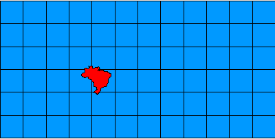

Selecting a subset of an existing layer
Subsets of existing layers in an Image Service can be included on the map as an additional layer of information. For example, assume a user selects Brazil from the Countries layer (id="1") and wants to see it highlighted in red. Your first instinct may be to select Brazil by using a SPATIALQUERY in LAYERDEF such as in the following request. Note that the States, Provinces, and Cities layers have had their visibility turned off for better viewing.
Using LAYERDEF to select Brazil:
  <REQUEST>
    <GET_IMAGE>
      <PROPERTIES>
        <LAYERLIST>
          <LAYERDEF id="1" type="polygon" visible="true">
            <SPATIALQUERY where="NAME='Brazil'" />
            <SIMPLERENDERER>
              <SIMPLEPOLYGONSYMBOL filltype="solid" fillcolor="255,0,0"/>
            </SIMPLERENDERER>
          </LAYERDEF>
          <LAYERDEF id="4" visible="false" />
        </LAYERLIST>
      </PROPERTIES>
    </GET_IMAGE>
  </REQUEST>
</ARCXML>
The problem with this scenario is the returned map shows only the Country of Brazil.
Brazil

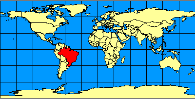

Although the above map shows the correct results, most people would expect to see all the countries with only Brazil highlighted in red. This can be done using a dynamic layer that shows Brazil as the selected country.
When setting up this type of dynamic layer, the DATASET refers back to the layer in the Image Service using its ID. In this example, DATASET fromlayer="1" refers to the Countries layer. The rest of the LAYER elements are used the same way as in a map configuration file. Each dynamic layer should have a unique ID that is not already used in the map configuration file or with other dynamic layers.
Using a dynamic LAYER to select Brazil:
  <REQUEST>
    <GET_IMAGE>
      <PROPERTIES>
        <LAYERLIST>
          <LAYERDEF id="4" visible="false" /> <!--Cities-->
        </LAYERLIST>
      </PROPERTIES>
      <LAYER type="featureclass" name="Countries" visible="true" id="10">
        <DATASET fromlayer="1" />
          <SIMPLERENDERER>
          </SIMPLERENDERER>
      </LAYER>
    </GET_IMAGE>
  </REQUEST>
</ARCXML>
The resulting map shows two layers of countries. The bottom layer includes all the countries. The top layer includes only Brazil highlighted in red.
Brazil in dynamic layer

Using a dynamic LAYER to add a Rivers layer:
  <REQUEST>
    <GET_IMAGE>
      <PROPERTIES>
        <LAYERLIST>
        </LAYERLIST>
      </PROPERTIES>
      <LAYER type="featureclass" name="Rivers" visible="true" id="20">
      <DATASET name="RIVERS" type="line" workspace="shp_ws-0" />
      <SIMPLERENDERER>
        <SIMPLELINESYMBOL width="1" captype="round" color="0,0,255" />
      </SIMPLERENDERER>
      </LAYER>
      <LAYER type="featureclass" name="Selected Countries" visible="true" id="10">
        <SPATIALQUERY where="NAME=&apos;Brazil&apos;" />
          <SIMPLERENDERER>
          </SIMPLERENDERER>
      </LAYER>
    </GET_IMAGE>
  </REQUEST>
</ARCXML>
The resulting map shows the world rivers added as a dynamic layer.
Rivers added
Adding acetate layers dynamically
Acetate layers display additional features on top of a map. The acetate layers are visible only in the HTML Viewer and viewers using the ColdFusion, ActiveX, or Java Connectors, not ArcExplorer 4 or the Java Viewers.
Acetate layers are made up of one or more OBJECTs. The different objects include points, lines, polygons, text, north arrows, and scale bars. For details on the OBJECT element and children elements, refer to the Notes Section of OBJECT. Each object is placed on the acetate layer using screen coordinates or database coordinates. Screen coordinates are in pixels referenced from the bottom left-hand corner of the map frame. Database coordinates are in the coordinate system of the map.
In the example below, a north arrow is added using screen coordinates. "Indian Ocean" is added as text using map coordinates.

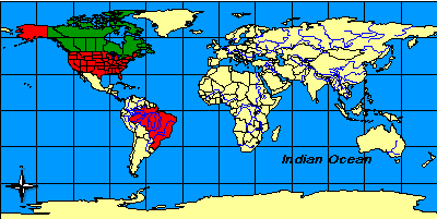

Using a dynamic LAYER to add an acetate layer:
  <REQUEST>
    <GET_IMAGE>
      <PROPERTIES>
        <LAYERLIST>
        </LAYERLIST>
      </PROPERTIES>
      <SIMPLERENDERER>
      </SIMPLERENDERER>
      </LAYER>
          <SIMPLERENDERER>
          </SIMPLERENDERER>
      </LAYER>
      <LAYER type="acetate" name="acetate" id="acetate">
        <OBJECT units="database">
          <TEXT coords="50 -45" label="Indian Ocean">
            <TEXTMARKERSYMBOL fontstyle="bolditalic" fontsize="12" />
          </TEXT>
        </OBJECT>
        <OBJECT units="pixel">
          <NORTHARROW type="1" size="15" coords="20 80" shadow="32,32,32" />
        </OBJECT>
      </LAYER>
    </GET_IMAGE>
  </REQUEST>
</ARCXML>
The returned map shows three dynamic layers: Brazil as a selected country, world rivers, and the north arrow and text in the acetate layer.
Acetate layer included

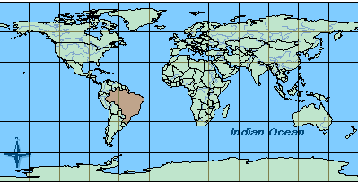

To place all dynamic layers before the LAYERLIST, the LAYERLIST attribute dynamicfirst can be set to true. No changes need to be made in the layer order in the request but all dynamic layers are drawn first. In the next example, dynamicfirst is set to "true". In order to see the dynamic layers, the transparency of the Ocean and Countries layer has been set to 50 percent (filltransparency="0.5").
Drawing dynamic layers first using LAYERLIST dynamicfirst:
  <REQUEST>
    <GET_IMAGE>
      <PROPERTIES>
        <LAYERLIST dynamicfirst="true" >
          <LAYERDEF id="0" type="polygon" visible="true">
            <SIMPLERENDERER>
              <SIMPLEPOLYGONSYMBOL filltype="solid" fillcolor="0,153,255" filltransparency="0.5" />
            </SIMPLERENDERER>
          </LAYERDEF>
            <SIMPLERENDERER>
              <SIMPLEPOLYGONSYMBOL filltype="solid" fillcolor="255,255,153" filltransparency="0.5" />
            </SIMPLERENDERER>
          </LAYERDEF>
        </LAYERLIST>
      </PROPERTIES>
      <SIMPLERENDERER>
      </SIMPLERENDERER>
      </LAYER>
          <SIMPLERENDERER>
          </SIMPLERENDERER>
      </LAYER>
          </TEXT>
        </OBJECT>
        </OBJECT>
      </LAYER>
    </GET_IMAGE>
  </REQUEST>
</ARCXML>
The returned map image shows the dynamic layers drawn first underneath the layers in LAYERLIST.
dynamicfirst

In the next example, the layers are ordered in LAYERLIST in the order in which they should appear in the image. The Cities layer is not included in the LAYERLIST and is not included in the output map image.
Using LAYERLIST order to change the order in which layers are drawn:
  <REQUEST>
    <GET_IMAGE>
      <PROPERTIES>
          <LAYERDEF id="10" visible="true" />
          <LAYERDEF id="20" visible="true" />
          <LAYERDEF id="acetate" visible="true" />
        </LAYERLIST>
      </PROPERTIES>
      <SIMPLERENDERER>
      </SIMPLERENDERER>
      </LAYER>
          <SIMPLERENDERER>
          </SIMPLERENDERER>
      </LAYER>
          </TEXT>
        </OBJECT>
        </OBJECT>
      </LAYER>
    </GET_IMAGE>
  </REQUEST>
</ARCXML>
The returned map image shows the dynamic layers mixed in with the Image Service layers.

In the response, the ENVELOPE coordinates are in Robinson, which was the coordinate system used in FEATURECOORDSYS.
IMAGE response with new ENVELOPE coordinates:
<?xml version="1.0" encoding="UTF8"?>
  <RESPONSE>
    <IMAGE>
      <ENVELOPE minx="-16986708.7102836" miny="-12740031.5327127" maxx="16986708.7102836" maxy="12740031.5327127" />
      <OUTPUT file="C:\ArcIMS\output\world_MYCOMPUTER29852440.png" url="http://mycomputer.domain.com/output/world_MYCOMPUTER29852440.png" />
    </IMAGE>
  </RESPONSE>
</ARCXML>
The returned map image shows the map in the Robinson coordinate system.
Robinson
Note that the acetate OBJECT with the text "Indian Ocean" is no longer placed correctly. The problem is the OBJECT coordinate units are in geographic coordinates, while the map has been transformed to Robinson. COORDSYS can be used with an acetate OBJECT to let the ArcIMS Spatial Server know the coordinate system of the OBJECT. In the example below, COORDSYS has been added to the "Indian Ocean" object.
Including COORDSYS in the acetate layer:
  <REQUEST>
    <GET_IMAGE>
      <PROPERTIES>
        <FILTERCOORDSYS id="4326" />
        <FEATURECOORDSYS id="54030" />
        <LAYERLIST>
        </LAYERLIST>
      </PROPERTIES>
      <SIMPLERENDERER>
      </SIMPLERENDERER>
      </LAYER>
          <SIMPLERENDERER>
          </SIMPLERENDERER>
      </LAYER>
            <COORDSYS id="4326"/>
          </TEXT>
        </OBJECT>
        </OBJECT>
      </LAYER>
    </GET_IMAGE>
  </REQUEST>
</ARCXML>
The returned image shows the map and the "Indian Ocean" OBJECT in the Robinson coordinate system.
Robinson

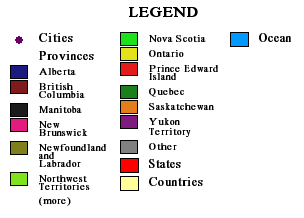

Using LEGEND and DRAW
LEGEND can be used in a GET_IMAGE request to include a legend for the requested map. The legend is an additional image in the same format as the map: JPG, PNG, or GIF. DRAW can be used to request only a legend rather than both a legend and a map.
The following GET_IMAGE request includes a default LEGEND since no attributes are used. DRAW has the attribute map set to "false" so that only a legend is returned.
GET_IMAGE request with LEGEND:
  <REQUEST>
    <GET_IMAGE>
      <PROPERTIES>
        <LEGEND />
        <DRAW map="false" />
      </PROPERTIES>
    </GET_IMAGE>
  </REQUEST>
</ARCXML>
In the response, only the name and location of the legend are included.
IMAGE response with LEGEND:
  <RESPONSE>
    <IMAGE>
      <LEGEND file="c:\arcims\output\world_MYCOMPUTER1248849.png" url="http://mycomputer.domain.com/output/world_MYCOMPUTER1248849.png" />
    </IMAGE>
  </RESPONSE>
</ARCXML>
Default Legend The returned legend image includes all layers that are currently visible in the map on a white background.

Two images are returned in two separate IMAGE responses. In the first response, the map name and location is sent. In the second response, the legend name and location are sent. In the images, the map contains all layers, while the legend does not include Ocean or Countries.
Map Legend

      </SIMPLERENDERER>
      </LAYER>
          <SIMPLERENDERER>
          </SIMPLERENDERER>
      </LAYER>
          </TEXT>
        </OBJECT>
        </OBJECT>
      </LAYER>
    </GET_IMAGE>
  </REQUEST>
</ARCXML>
The returned map is the same as the previous example. However, the legend does not include the "Selected Countries" layer.
Acetate layer included Legend
