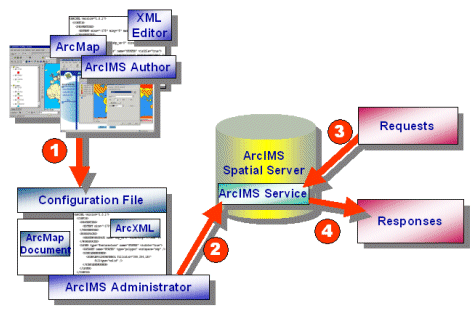

ArcXML is the protocol for communicating with the ArcIMS Spatial Server. An ArcIMS Spatial Server is the backbone of ArcIMS and provides the functional capabilities for accessing and bundling maps and data into the appropriate format before sending the data back to a client. In order to understand ArcXML, it is first necessary to understand how configuration files, ArcIMS services, requests, and responses relate to each other and how they interact with the ArcIMS Spatial Server.
The figure below is a diagram showing the interaction between the ArcIMS Spatial Server and configuration files, services, requests, and responses. The numbers in the diagram reflect the different steps involved in communicating with the ArcIMS Spatial Server:
diagram

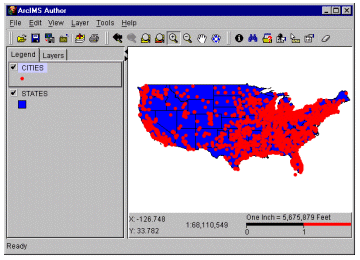

The next figure shows a map in ArcIMS Author with two layers: STATES and CITIES.
Author
When this file is saved in ArcIMS Author, the result is a map configuration file, written in ArcXML, containing layer information on STATES and CITIES. The file has an *.axl extension. In this example, assume the file is named usa.axl.

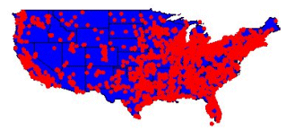

When the above request is sent to the usa_image service, the result is a map that looks like the original map defined in ArcIMS Author. The layer symbol definitions from the service are used: blue for the states and red for the cities.
request
